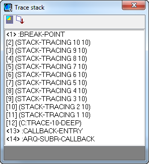

例如,在 Visual LISP 中加载以下代码,按照代码注释中指示设置断点,然后启动 TRACE-10-DEEP 命令。
(defun stack-tracing (indexVal maxVal)
   (princ "At the top of the stack-tracing function, indexVal = ")
   (princ indexVal)
   (if (< indexVal maxVal)
      (stack-tracing (1+ indexVal) maxVal)
      (princ "Reached the maximum depth.") ; place a breakpoint
                                          ; at the beginning of
                                          ; this line
(defun c:trace-10-deep ()
   (terpri)
   (stack-tracing 1 10)
当程序执行在设置的断点处中断时,前面示例代码中的“跟踪堆栈”窗口如下图所示。
